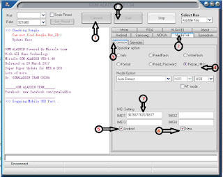

Download GSM Aladdin from here google
Extract and launch the "loader.exe"
Click on Connect button
navigate to Mediatek Tab
Click on Common
Click Repair_IMEI
Tick Android and tick NEW
Type 15 digit IMEI
Connect Smartwatch to USB cable while holding Power key.
Wait till process complete..
Done.
You have successfully fixed Parameter Is Invalid on MTK Smartwatches.
See Screenshot below ...
